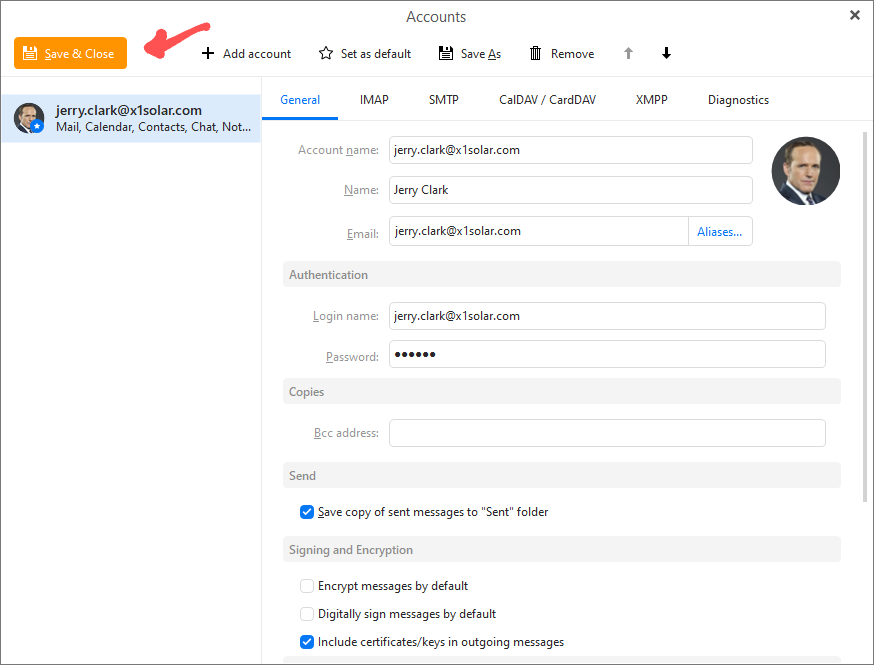

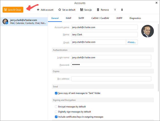

At the top left of accounts is Save & Close button as in the eM Client account example screenshot below.
To get back into Accounts, click “Menu / Accounts”.
