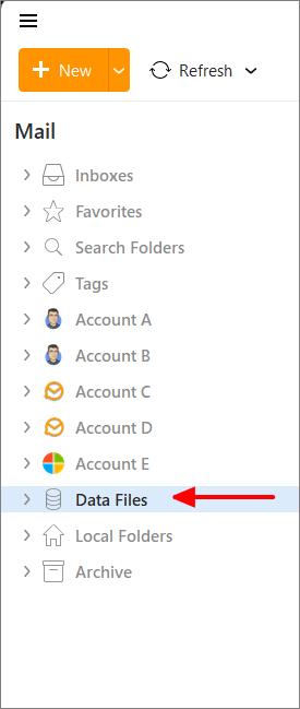

eM Client 10 has a new function called Data Files. A Data File is like a PST file. They can be mounted (or unmounted) from your main database and even stored in different location. You can also move some of your messages into these separate files for archiving reasons or easy sharing. When mounted, you will see them below your other accounts.
This export option allows you to export messages to a Data File (*.emdf) which you can later mount in eM Client.

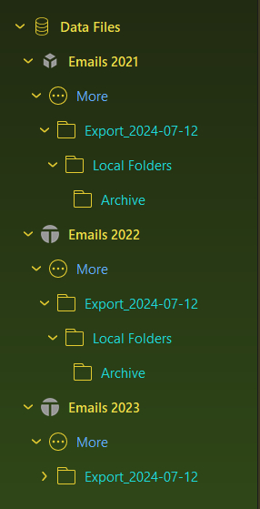

After testing the functionality of emdf files, I found out that the best and most correct use is the following. I had emails or 2021,2022 & 2023 backed-up in eml format. What I did: I created in local folders separate folder for each year and I imported the relative email files per year. Then I exported them ( per year ) in emdf files. In this way I deleted the eml folders of 2021,2022,2023 in local folders ( keeping of course keeping the initial eml folders in an external drive. Then I mounted the 2021,2022,2023,emdf files . In this way I can follow emails of previous years without increasing the size of the database when backup.
See atttached inage. You will understand better what I did.

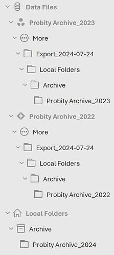

I did the same thing you did. Before emdf was available (only became a feature in V10) I archived old emails by year to my local folders to remove them from the server. With V10 I have taken years 2022 and 2023 and exported them to emdf files. Deleted the local folder containing these same messages from EMClient and mounted the emdf files so I still have access to them.
I did not export the individual emails as .eml. I did not see the reason for the duplication of .eml and .emdf backups.
My scenario of removing 5.5gb of emails from local folders has not made any difference to the size of my backup zip file. This does not seem correct to me.

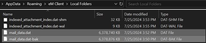

I did run the cleanup using the command line. It appeared to complete correctly as I do now have the dat-bak files in my local database. Comparing the dat files to the dat-bak files does not show any real size difference for the local folders that would account for removing 5.5gb of emails from that folder. Both the mail_data.dat and mail_data.dat-bak files are over 6gb
