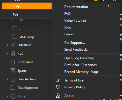

@Ben18 Maybe your messages are being categorized, which may take some time. Try to disable inbox categories temporarily. If you still experience the freezing, please try Profile for 10 options in Help menu and send us results:
