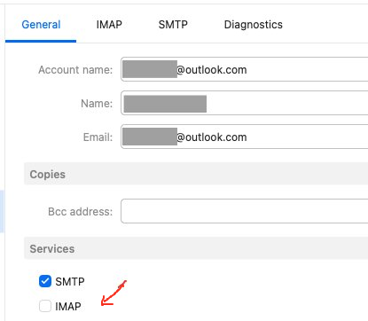

So if you want to disable your IMAP account from receiving mail, open your account and go to the General Tab and uncheck the IMAP box under Services as in this Outlook.com example. Then Save accounts. Then close and reopen eM Client. You can then enable it anytime later.

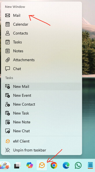

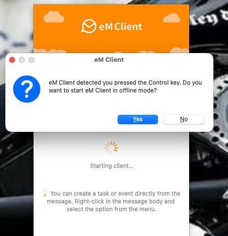

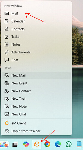

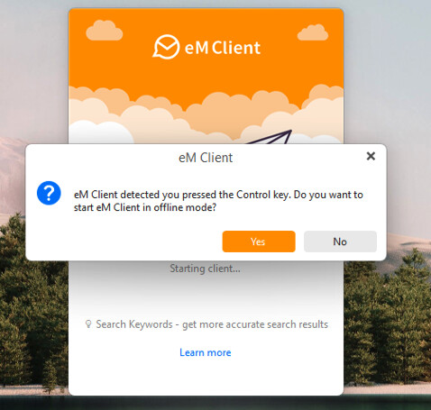

If you have eM Client for Windows in a Virtual Box like this example below on eg: “Mac with eM Client V10.4.5326 with Windows 11 Pro running in Parallels Virtual Box”, then hold down the Ctrl key and while holding “right click” on the eM Client icon on the Taskbar and then click “Mail” under new window at the top and you should then see the Splash screen with a message "Do you want to start in Offline Mode.

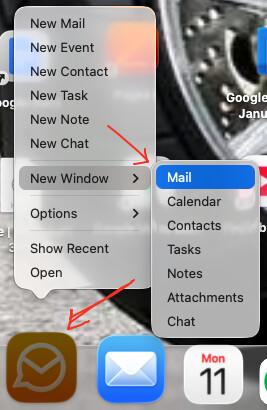

Also for eM Client on Mac users while holding down the Ctrl key “right click” on the Dockbar “New Window / Mail”, which also asks if you want to start in offline mode as in the below eM Client V10.4.5326 under Mac OS 26.4 example screenshot below.

Again for the benefit of others who may find this discussion, the Windows version works similarly. When I right click, the pop-up list doesn’t have the option for “New Window”, so I just clicked on the “New Mail” option. As you describe, when eM Client finally initializes, it does pop up the same message you show asking if I want to work in offline mode. Once I answer that question, it will then show the New Mail window.
