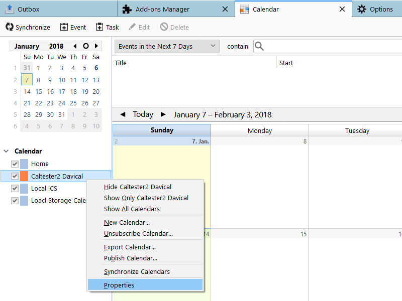

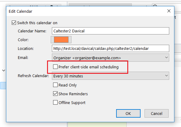

Wondering if eM Client could possibly eg: program an option in the “Calendar Properties” for CalDAV online calendar accounts (similar to what Thunderbird does with the Lightning add-on / plugin which schedules below) to then “send online calendar invitations locally instead”, for the CalDAV servers which just don’t seem to send, due to they either “don’t have online scheduling invitation capabilities” or their online calendar scheduling server just “doesn’t seem to ever send invitations for some unknown reason”.
“Thunderbird Mail”
Prefer client-side email scheduling
https://support.mozilla.org/en-US/kb/enable-email-invitations-caldav-servers-configured
Quote:-
“To enable it, switch to the calendar or task view, and right-click on the respective caldav calendar and select the properties item in the context menu”.
“Now, you just check the option “Prefer client-side email scheduling”, which is available below the dropdown list to select an email identity. This option will be only visible for CalDAV calendars but not for any other type of calendar”.
