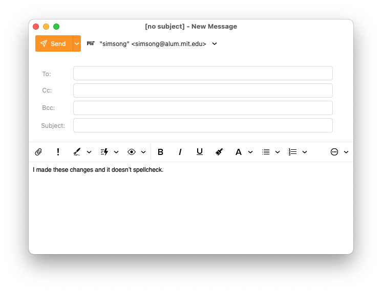

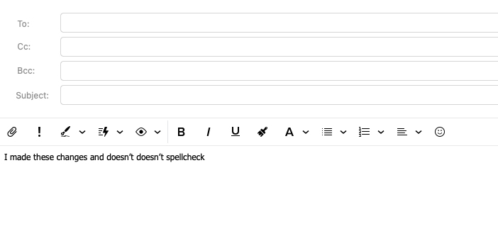

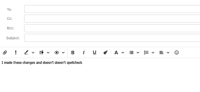

I made these changes and doesn’t doesn’t spellcheck. The problem seems to be (if you look closely at the screen shot) that eM client is putting in a smart-quote and the spelling dictionary has a dumb-quote.
I cannot replicate that problem. If i type that same line with english auto spell checking enabled, the word doesn’t (is picked up with no errors). So it is being included in the auto spell checking.,

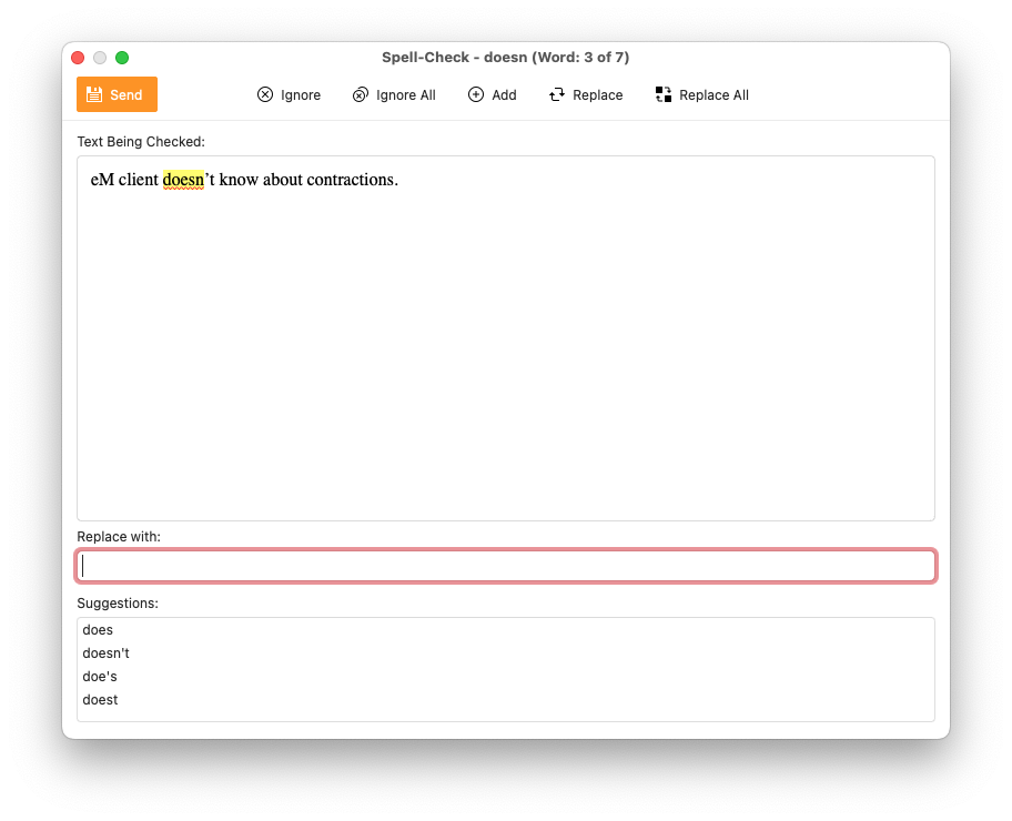

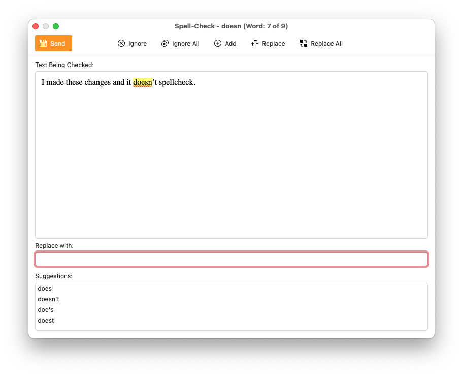

It doesn’t pick up the error when you write; it generates the error when I click ‘send’. See below:
That does not happen to me when i press send using V9.2.2054 for Windows or Mac.
When i type exactly that sentence and press send, the email goes into the outbox and shows “no spellcheck errors” and then goes into the sent box and arrives at the other end with no errors.

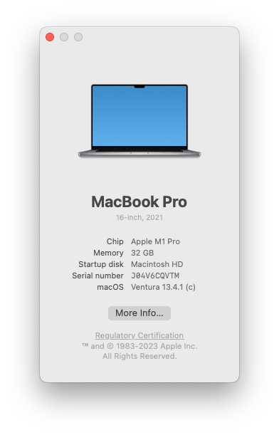

What version of eM Client are you using ? Also are you using Windows or Mac and what OS version ?

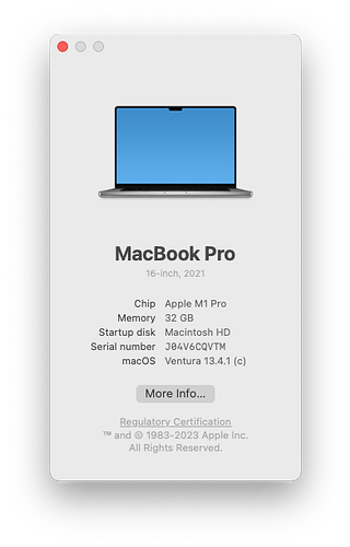

Here is the relevant information:

The problem is because you are doing “a manual spell check” either manually before sending the email, or you have the option enabled in settings to “check spelling before sending”.
So to disable the manual spell check before sending (if you have that enabled on your Mac), go to “eM Client / Preferences / Mail / Compose” and disable the box marked “Check spelling before sending message”. Then “Save & Close” Settings.
If you didn’t have that settings enabled, then “just setup the automatic spell check” in eM Client Settings as previously mentioned above, and “don’t manually check” which will then also avoid that problem.

Yeah, I think it has to do with the smart apostrophe which is detected differently in the manual spell-check to the automatic one.
I have asked our developers to look into it.
