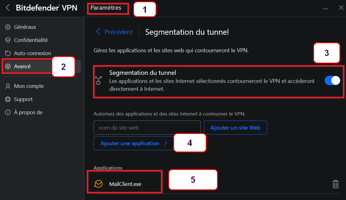

Note: - There is also a user on this forum @ekalb that uses Bitdefender VPN and says it works ok. See what he advises in the thread below. So might give you some clues to help with that..
Take a look here (sorry, it’s in french):

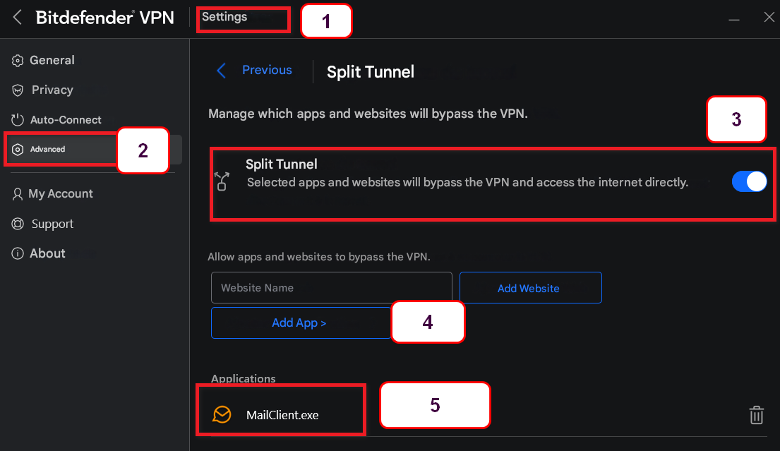

Hey @All
Here it is translated to English

Thank you, I di read French. Bypassing the VPN (tunnelling) is not a smart thing to do, because the idea of the VPN is not to use the local Wi-Fi provider like the ones in a cafe or hotel. If I bypass the VPN the login info can be intercepted by the router provider.
I will try your advise and contact Bitdefender. Will publish the results if I will get any solution.
