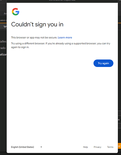

Version 10 Google authenticator
I have installed this version.
Before I was using version 9 without any problems with Google.
Now I have this error.
I have tried deleting the old Google account and recreating it but I can’t get over this point.
Can anyone help me?
Thank you very much.

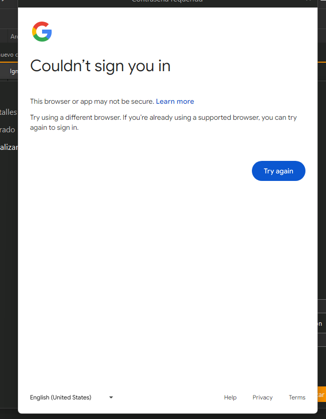

Hello again:
I have tried installing emclient on another Windows 10 computer and everything perfect, with the same Google account. But then I reinstalled it again on the new computer with Windows 11 and I still get the same error.
I also installed Firefox with a clean install and set it as default, but all the same.
What a madness. No one has had similar problems with Windows 11?
Thanks.

Hello:
I have done some tests.
I created another user on the same computer with W11 and installed EmClient. It worked fine, opening a large Edge window and logging in correctly.
I then logged into W11 with the other local account that is giving me problems and uninstalled all the browsers I have (Chrome, Edge, Firefox). I haven’t left any of them.
Surprisingly, after uninstalling them, I open EmClient and when I try to authenticate the Google account, the same small window that gives me the errors opens again.
Does EmClient have its own browser?
I think that’s where I may have the problem.
Thank you.
