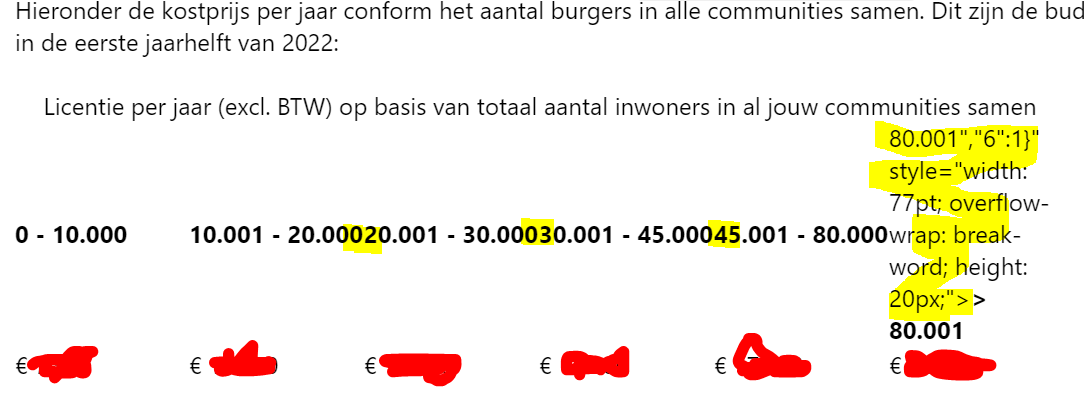

How can I prevent the table becoming messy after I have send an email?
I indicated the issues in yellow (1) space between column headings gone (2) pure code output within the email message:

Hello
Thanks in advance!

Copy-paste from Excel. Edited within EMC 8.2.
Other emails seem to work smoothly.
While composing everything looked fine. After I got a reply I realised it was not okay, then I checked in the folder “send” to ensure it was EMC who messed up.

Figured out: the problem is using one of these symbols within the table “>” “<”
