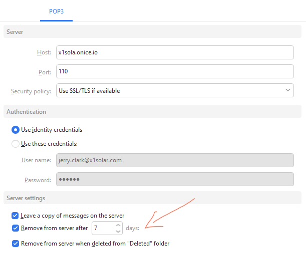

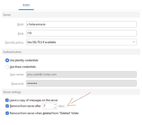

If you have a POP account you have to manually set when to delete on the server by going to “Menu / Accounts” and clicking the “POP3” tab and at the bottom you can adjust how many days to delete from the server as in the example below.
