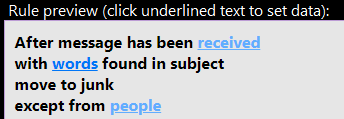

1./ In rules add the selection shown in image below
2./ Add the words

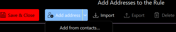

3./ Click on ‘people’ to open window ‘add addresses to rule’
4./ Hover over ‘Add address’ and click ‘v’ to show ‘Add from contacts’ as in image below

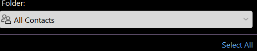

5./ In top right field click ‘v’ and select ‘All contacts’ then ‘Select All’
6./ At bottom right click ‘OK’ to close window and follow instructions.
