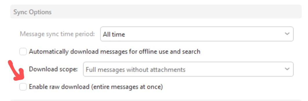

Alternatively you can also optionally enable “Raw downloads” in the Sync options as in the below V10 IMAP acct example.
Enabling Raw downloads can also speedup downloading attachments much faster, but “you might get issues with the attachments” as it doesn’t use the normal reliable chunk by chunk download method. Alot of users though say it works fine for them. So is an option you can try.
