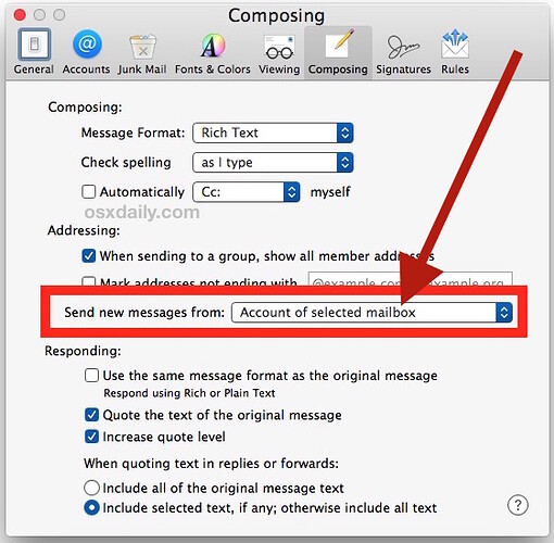

I just wanted to through my 2 cents in. The apple mail app has had this feature for years, and I would also like to see it in the em client.
