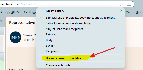

What are the settings for your search (drop down under magnifying glass)?
Is server-side search enabled? If so, try turning it off and see if the same issue happens, in case the wrong results were given by the mail server.
If that does not change it, please let us know what version of the app this happens with.
Turning off server search fixed the problem - but why would the server be turning in bad search results?
That would depend on the server, different ones could have the feature implemented differently - perhaps this mail server supports server search from 3rd party apps (not all do), but not exact phrase with the quotes “”, for example, in which case it might be returning all messages with words search, is, not and working in your example.

It took me a while to find where to disable server search, it’s not in the menu system but in the drop down menu in the search bar, click the down-arrow beside the magnifying glass. It’s called “use server search if available”. Mine had a check mark. Removing the check mark is making the search not return messages not containing any of my search terms.
