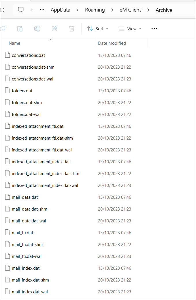

No, there are no folders within the Archive folder. There should be about 20 or so files like this, or at least the 7 dat files, and that is all:
Definitely there shouldn’t be a backup folder in the Archive.
Your copy of the database is broken, so you won’t see all the data in the application.
As your archive folder doesn’t appear to have the correct contents, see if there is then any recent backup.zip files in your “Documents\eM Client” profile folder on your backup drive.
As you may have previously setup automatic periodic backups in eM Client, and if they are there, you can then restore “the latest recent dated backup” by copying that back to your new profile Documents\eM Client folder, and then restore that in eM Client via the “Menu / File / Restore” option.
