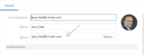

To make the alias email address the default address when composing & sending email, you would go to “Menu / Accounts / General” tab and “put the alias email address as the account email address” rather than your primary email address as per the example screenshot below.
