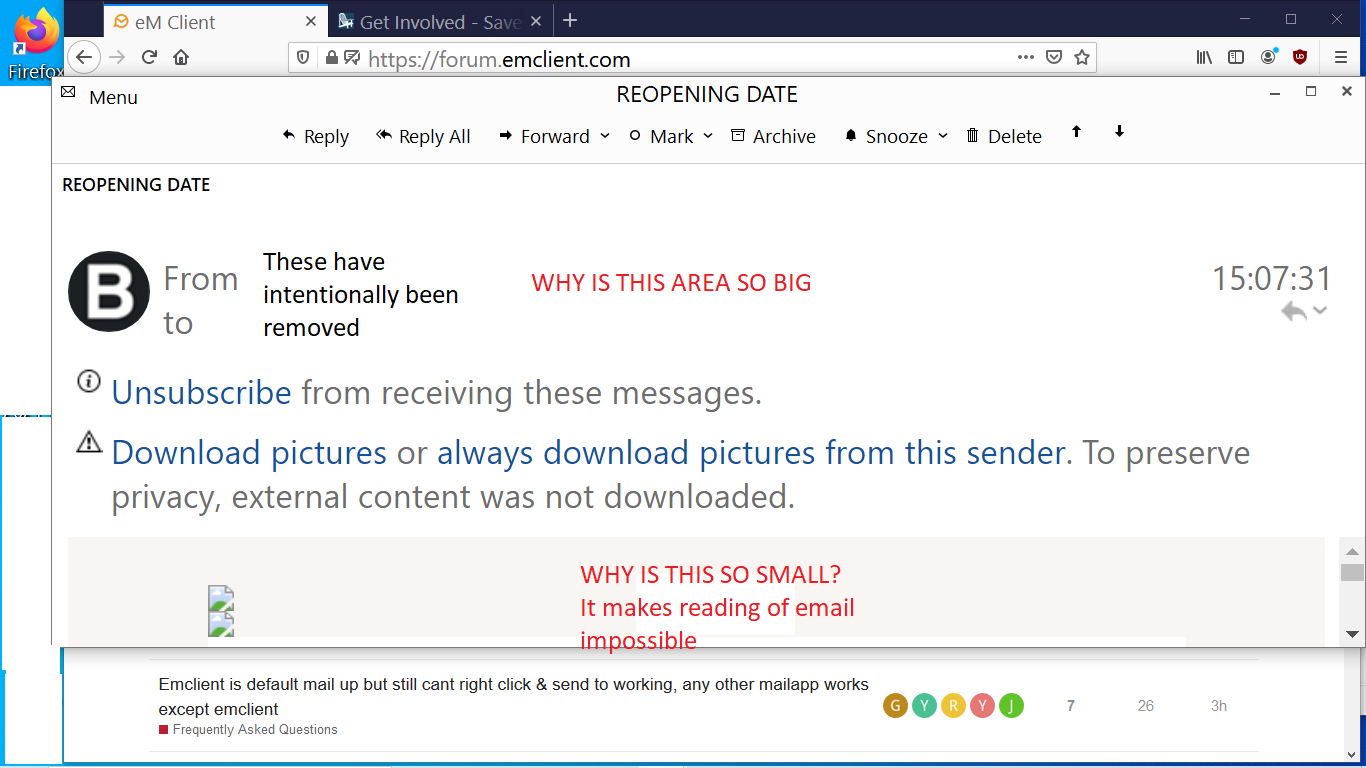

I have reinstalled this client but when I open an email to read it the top part, the one with the FROM, TO and the date and time of the email is huge and the portion of the actual email text is really squeezed down at the bottom.
Attached what happens. I’m running WIndows 10

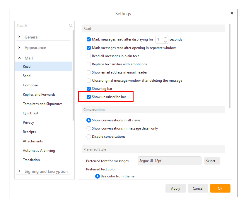

In version 8.2 the unsubscribe line can be hidden, so that will give you a little more room.
Otherwise, maybe try making the window a little larger vertically.
Hi Gary,
how can I hide it, from which of the many settings ?
THank you
Marco
You will need to wait for version 8.2 to be released.

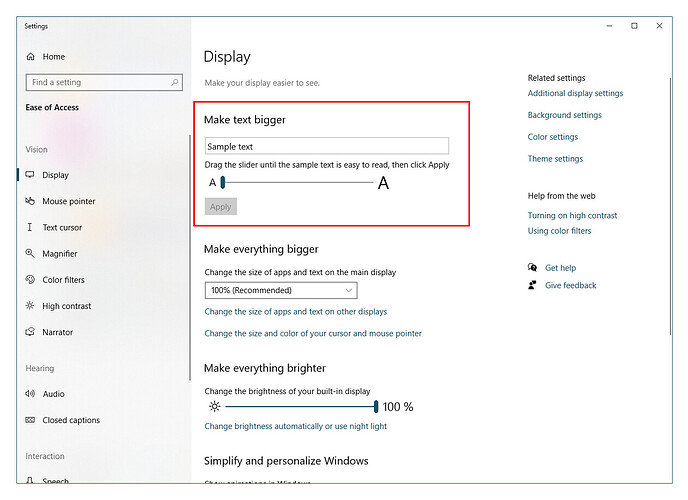

Ok I’ll wait but I also have problems with some of the pop-up panes in the configuration settings. They do not fit properly on screen and I can even scroll them to look at the content. This is what my Help->About pane looks like. I can’t even see the sw version I’m running. It has always been like this.
My screen resolution is at its highest too: 1366 x 768

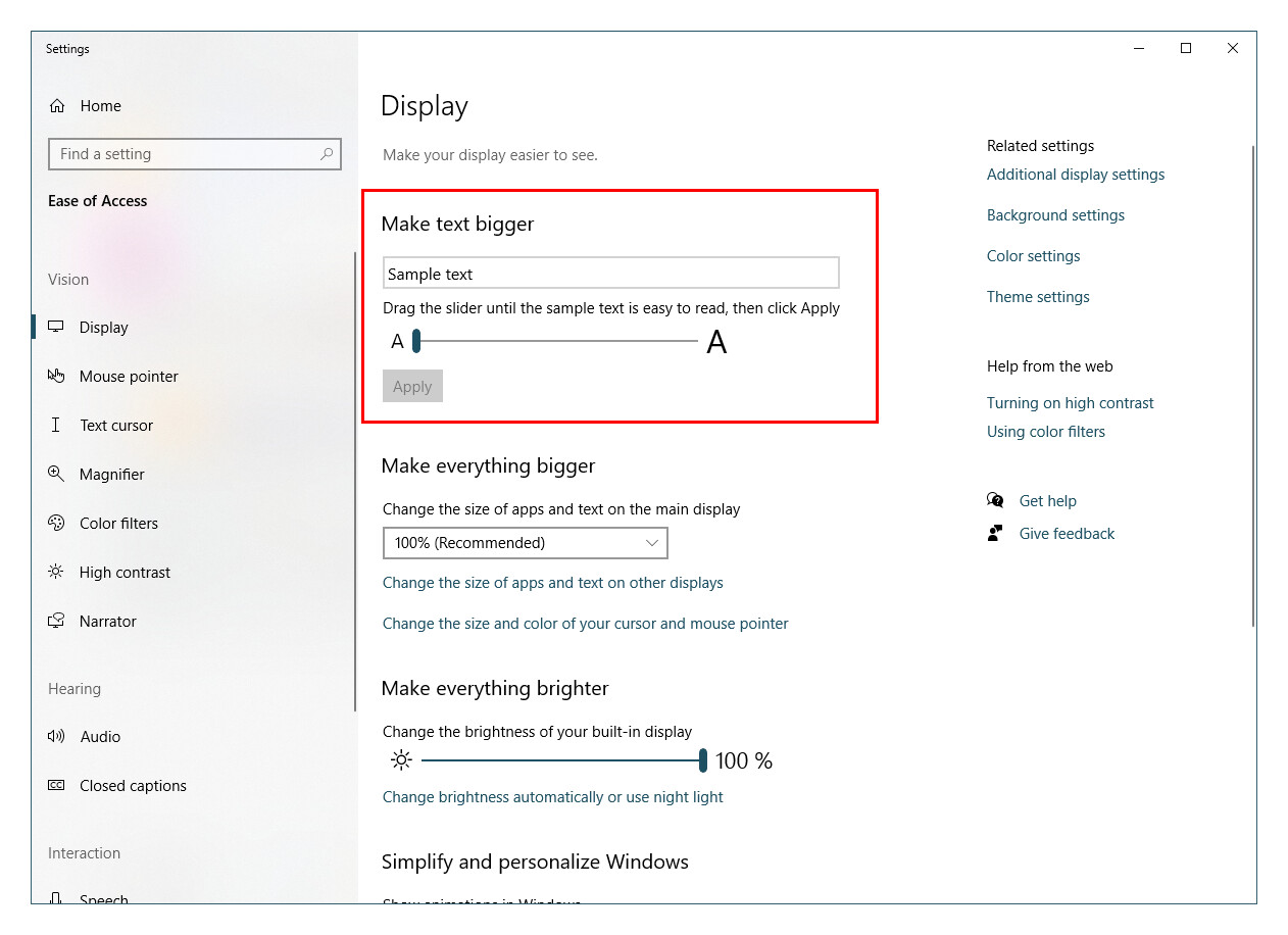

You need to change your Windows settings:
Put it back to 100%
found the setting. I’ll have to buy glasses now to read the pages
