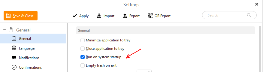

My new version 9.22258 opens automatically when I turn on the computer. Is there a way to activate it when I choose??
Go to “Menu / Settings / General” and remove the check next to “Run on system startup” & Save & Close.
(eM Client Windows example)
I did this and it worked.
