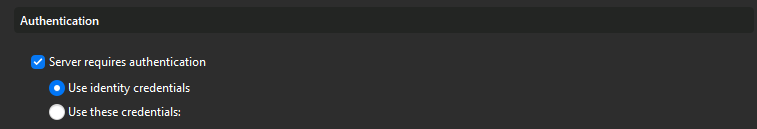

As your incoming mail works, then when manually setting up the account, “Ignore the SMTP diagnose button” and continue. Then go to accounts SMTP tab and set it to “Use identity credentials” as below screenshot example, and also check the port & security policy are still the same. Then save & close accts.
Then any current failed email in your Outbox, move it back to your Drafts folder & try sending again.
1000003186
If that still is saying your credentials were rejected “with the same username and password as your incoming”, I would contact your mail server technical support at Zentyal, as could be eg: they might need to enable something their end for you to send mail with a client compared to webmail.

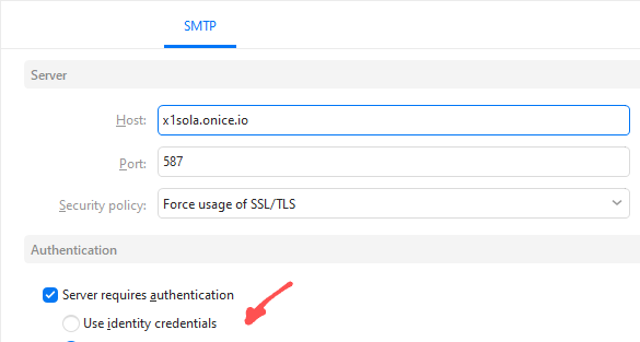

my SMTP setting is like this
when i used 587 port and Force usage of SSL/TLS then error
Authentication aborted
when i used 465 port and Use SSL/TLS on special port (legacy) then error
Connection failed due to the following reason: Cannot determine the frame size or a corrupted frame was received.
