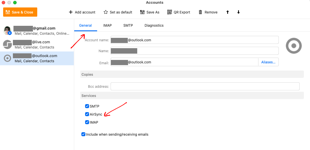

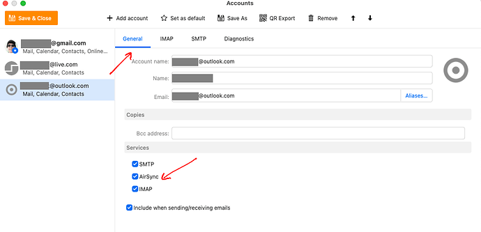

Ok as you have the latest eM Client version and removing and re-adding the Outlook account made no difference, then might be something possibly wrong then in your Acct Outlook settings.

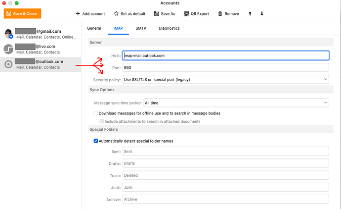

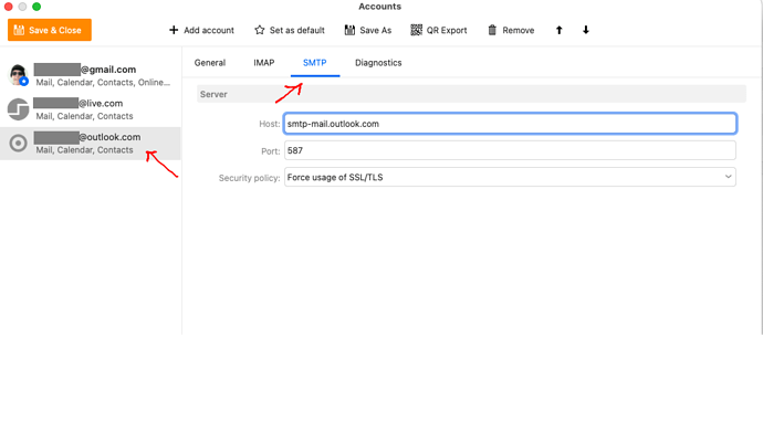

Go to âMenu / Accountsâ and highlight your Outlook account and then click the âGeneralâ tab and âIMAPâ tab and SMTP Tab and check what settings you have there. The below screenshots are what works in my Outlook acct.
Now if you already have the below settings, then other things that can cause connection errors are eg: Optional installed Firewalls / Security programs, Optional Antivirus programs and VPNâs. So if you have any of those try completely disabling those to test.

Check also the SMTP tab settings which i forgot to include in my screenshots above. Now updated in that post.
Hi zyberzork
You did kindly include SMTP and mine are the same as yours.

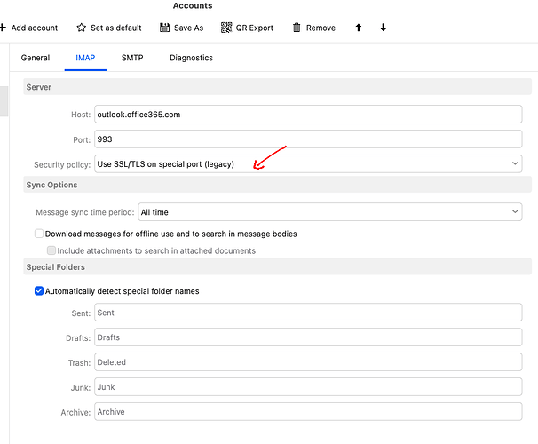

I would recommend though to use Port 993 for the IMAP Port as Port 143 normally doesnât provide any encryption. Port 993 is the secure port for IMAP and it works fine over TLS/SSL encryption.
Ps Ive tested that Server Address outlook.office365.com with my Outlook account and also works fine with IMAP Port 993. You just set the Security Policy to "Use SSL/TLS on Special port (Legacy) in eM Client as per screenshot example below.
