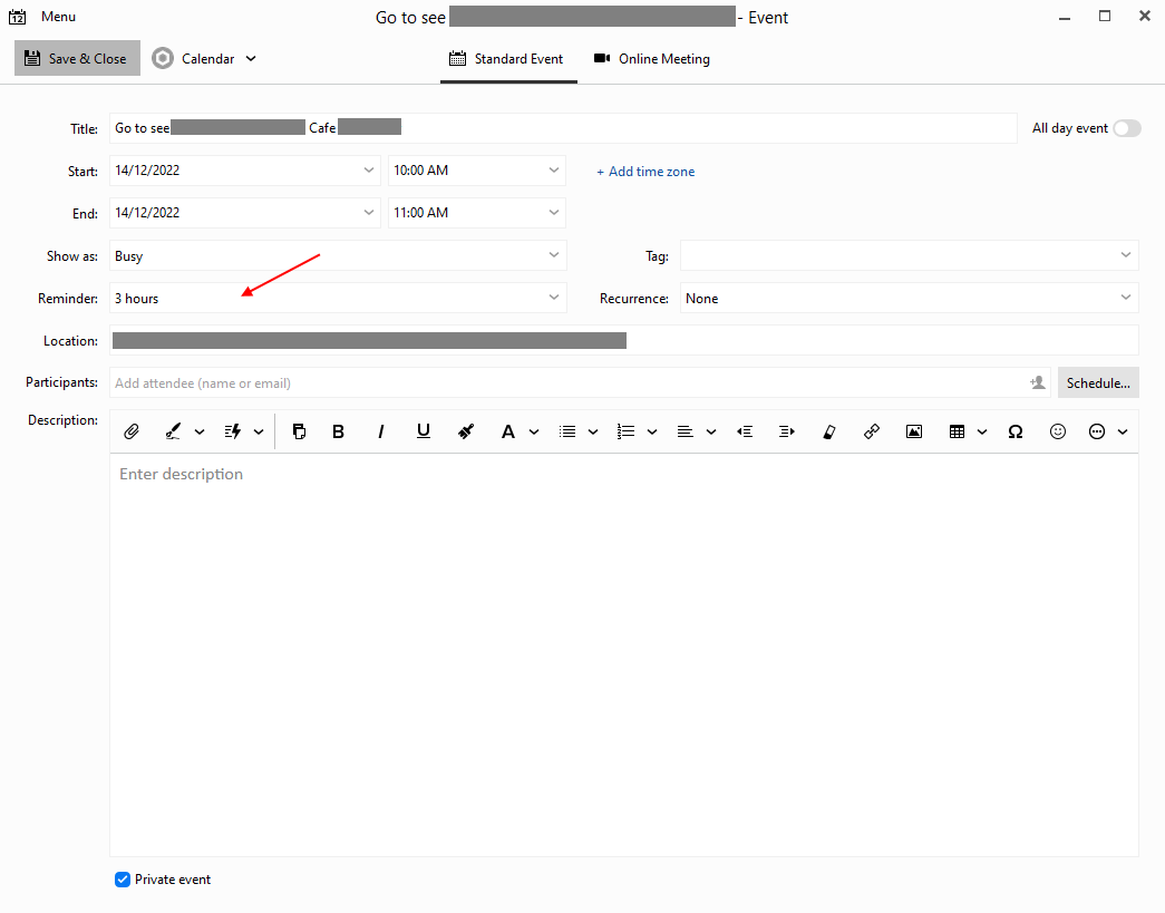

(Example of one of my Gmail calendar non-recurring events today with a 3Hour Reminder)
(Reminders settings) - No boxes checked.
