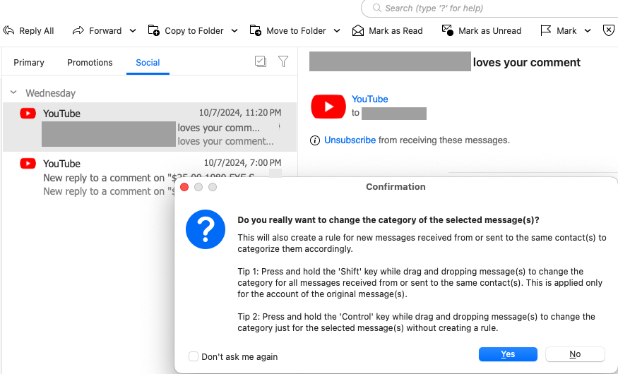

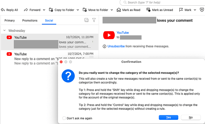

Now If there is a message/s that is going into a Category “where you don’t want it to go”, then you can just “Drag it” to the Category Tab you want. After you drag it, a popup message will appear as in the second screenshot below asking if you really want to change the Category.
If you then click Yes, a Rule will be created in eM Client Rules, so that senders message in future will then automatically appear in the new Category Tab.

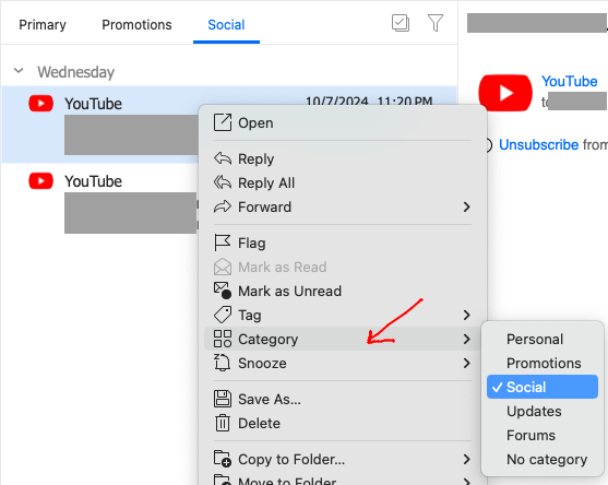

You can also "Right Click on the Message in any Category Tab, and then click “Category” on the menu, and select the Category you want it to go in future.
Either way. you will get the Prompt appear for you to confirm the change. There is also Shortcut keys you can use as well via the Tips.
(Dragging message to different category tab)
(Right click message and select differant category tab)
