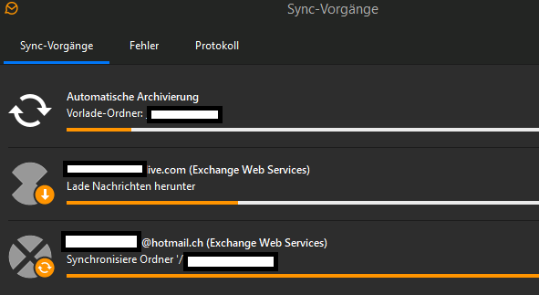

If so - Why other Mail Apps can handle this with EWS, but eM Client not?
Even in eM Client I’m able to receive new Mails, new Contacts, etc. If I click enough on “OK” when I’m asked for the password:
…in other Mail Apps it works whitout klicking “OK”.

Don’t tell me, it’s abaut the MS changes - If I click enough “OK” I get the new Maisl, Contacts, Notes, … even in em Client - While other Mail Clients do not force my attention and deliver all the canges - Without permanent Interaction.
