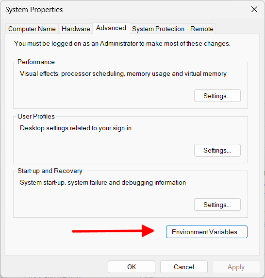

There isn’t anything in the %temp% folder you need to access, that you can’t access in eM Client itself. It is for temporary storage while the application is running, and is completely deleted when the application is closed. For those who have an issue with the space it takes in the default location, Windows of course offers an option as in my screenshot above to move the %temp% folder to another location.
Of course if you want to do it that way, that’s fine, but there is a very simple solution to the issue described in this topic, which is to change the location of %temp% in your OS settings.

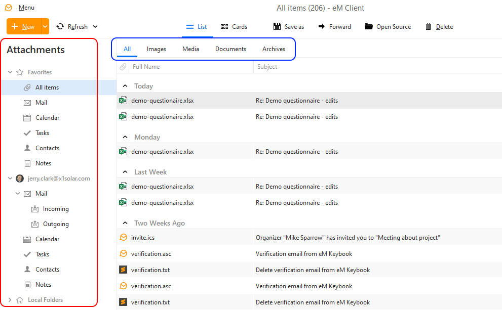

Well, it’s really off topic, because that is not the issue asked in this topic, but why not just access them in eM Client?
We do have an attachments section which will show all attachments, and you can see them there even if you haven’t opened them. However the %temp% folder will clear on every exit of eM Client, so will only show a few for a very limited time.
