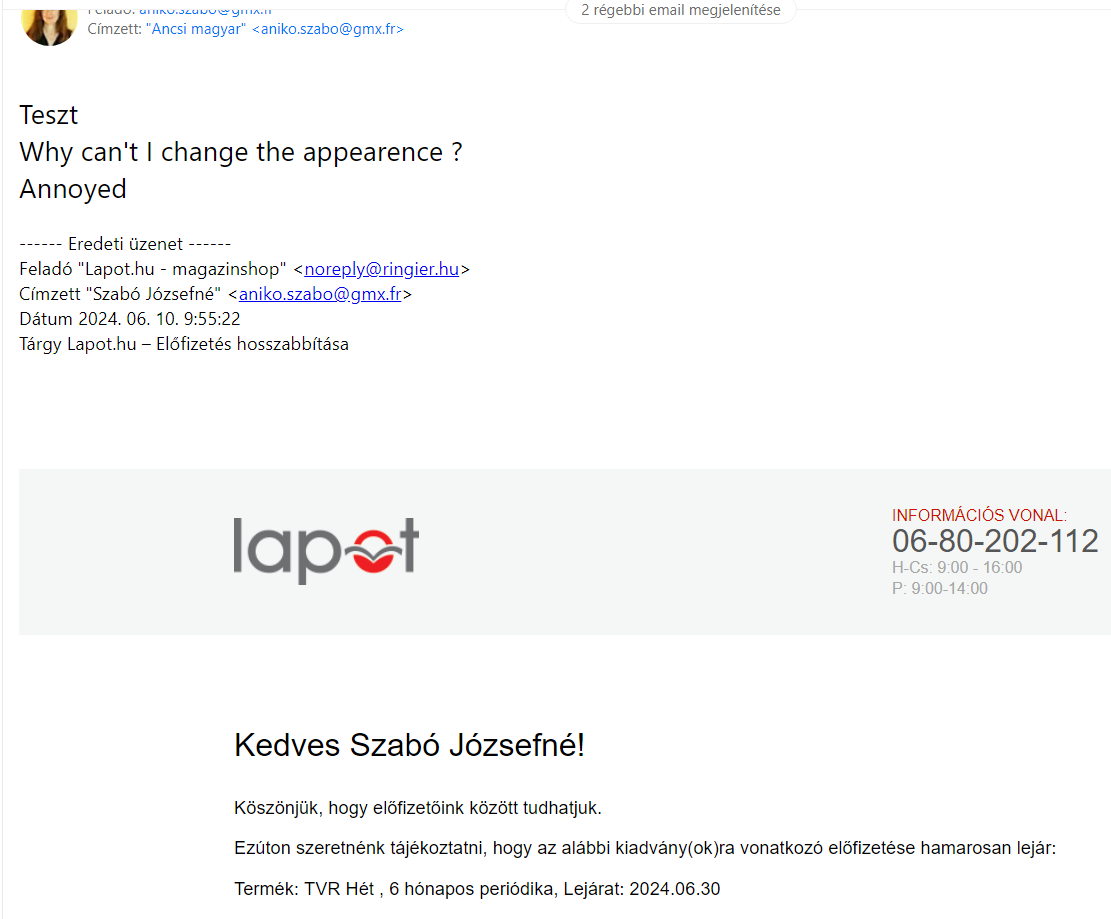

I don’t know what I’ve done wrong, but I’ve been using eM Client for years without a problem, but for a few weeks it’s nerving because the letter’s size by answering a mail is too small and I need to change it mail by mail.
I must have changed something in the settings, but I’ve been looking to repear it, can’t find a solution, then deleted & reinstalled the programme, nothing changed.
I’ve tried to look at Menu / settings / letter type & size, and many other places, but I can’t find where to change it back to the “original” state.
I get a normal email in a readable size, but when I click on “answer”, the whole mail and my typed letters appear in a much smaller size.
If I right click on my text, then “format” “letter panel”, I can see “letter size 3:12 points”. If I change the letter size to f.e. 5 points, which would be an easily readable size for me, it changes to a normal size.
But if I send the mail, my answer appears with “huge” letters, whereas the original is in normal, readable size.
Up until for a few weeks, everything was normal, normal letter size, same size than the original but readable. Now if I want to see what I type, I need to change the size in every single letter, then need to change it back before sending, so it’s very annoying.
Why have I done wrong, what have I changed? How can I get it back to normal size?
Thanks in advance.
Aniko
PS. Tried to post this with a few screen shots so that it’d be more understandable, but as a new member of the forum I can post only one. :frowning:

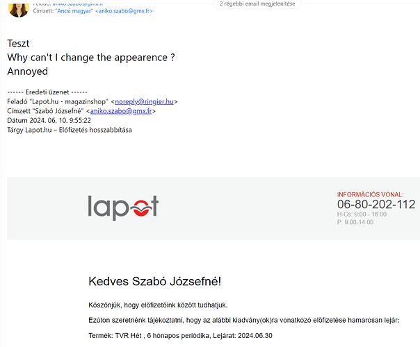

Probably you have zoomed out when in the compose window.
Start a reply.
Right-click in the message body and choose Zoom > Original.
Oh wow, that was quick & effective. I tried and it worked. Thanks a lot!
