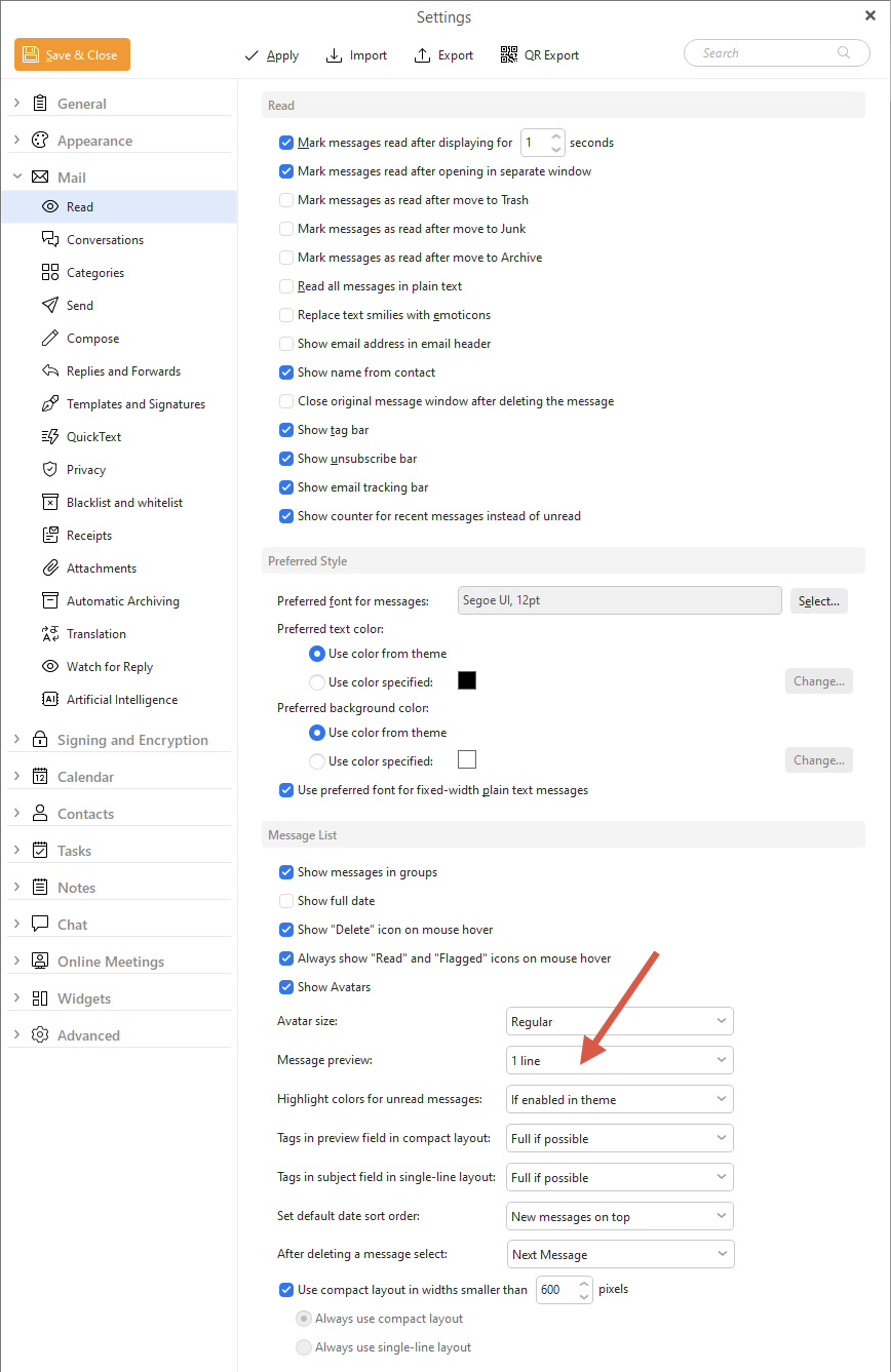

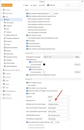

The email preview 1-3 line is set via “Menu / Settings / Mail / Read” as per example screenshot below. So check that setting.

Unfortunately even if I`m setting Menu / Settings / Mail / Read" back to 3 preview-lines this persists.

Could be then you are not in Compact Layout.
Go to “Menu / Settings / Mail / Read” and at the bottom make sure you are set on “Allways use compact layout” as per example below.
