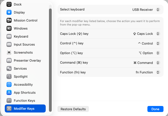

The Zoom-Shortcuts are not working.
Your keyboard Command and Control might be reversed. So try the Control key & + or - keys
You can check or change them in your Mac OS Settings / Keyboard / Keyboard Shortcuts / Modifier keys.
