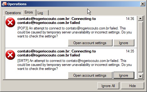

Internet connection drops when I try to send emails. This is a very strange behavior and it happens only with eM Client 2.5. I had no problems with the beta version.

eM Client doesn’t alter the network connection in any way, so I don’t think it is possible that it could cause the dropping connection that you describe. From the screenshots I can see that it was sending emails, when its connection has been terminated by something.

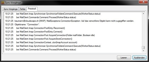

This is the error i get…
I get the same issue connecting to GMAIL IMAP. how do we fix?
