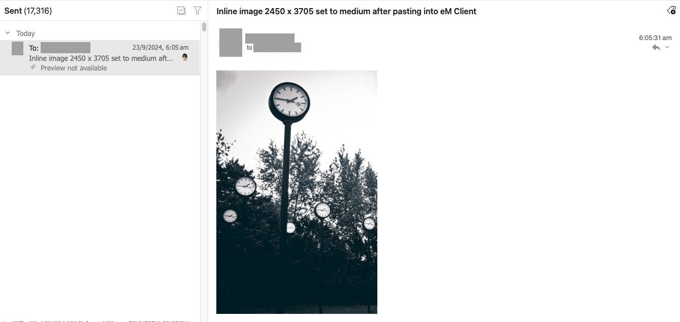

Here is another new composed email using V10.0.3530 this time using the Mac with an Inline Portrait .JPG Image 2450 x 3705 pixels that after pasting, i clicked the image and set it to “Medium” which then in Custom is 317 x 480 pixels.
Image sent in eM Client Sent box still the same size & aspect ratio…
Image sent in eM Client viewed in Sent box Gmail still the same size & aspect ratio.
Image received in eM Client Primary Inbox is still the same size & aspect ratio.
Image received in Gmail Primary Inbox is still the same size & aspect ratio.
