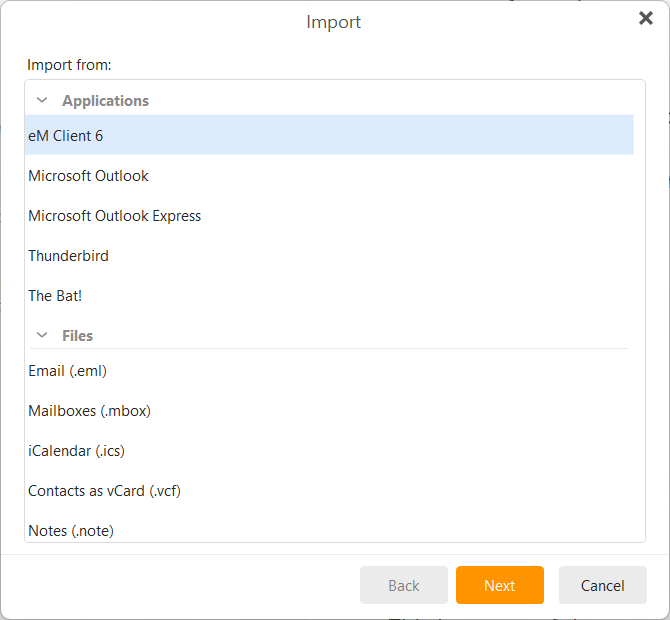

Option (2) - copy the entire database folder (C:\Users{username}\AppData\Roaming\eMClient) onto an external disk and import into the new eM Client - error message
“The selected directory doesn’t contain eM Client data files or the data files were created with too old version of eM Client”
Well both those statements are clearly not true so by definition there is a bug in the software, but surely there must be a workaround?

This can happen if you are trying to import from version 6 to 9, it may not work as that is a very old version.
What you can do is install version 8 instead, then do the import from 6, then upgrade to 9.
Thanks Gary, but as I pointed out in my original post, "Set up the new PC, installed the exact same binary of eM Client " - i.e. both are on 9.2.2157 (5b49542)
There is only one import from eM Client option, and that is the import from 6.
In most cases if you try to use that in version 9, you will get the error you gave.
It won’t import version 9 data, it will try to import version 6 data which may not be there. Therefore the error. It’s not a bug.

So is there not an import option for the scenario I’m in? Just move the database over and carry on from there?
Yes. See the link I gave which gives instructions for moving across to a new device either using backup/restore or moving the database folder manually.
Yeah ok done that thanks.
