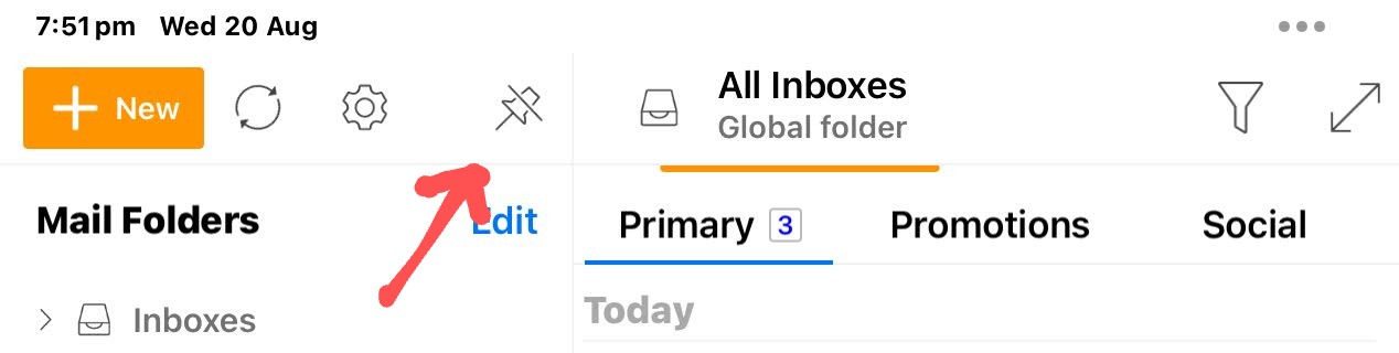

I since discovered you can actually hide the folders panel in Landscape view by pressing the (pin) button on the right of the Settings cog.
Ps Sorry I never tried that button before.

Thats strange its differant. The pin button appears in Landscape view automatically at the top right of the mail folders using eM Client iOS “Testflight” iPad Beta V10.3.2242 and iOS 18.6.2 on both my M1 iPads. So you might be possibly using the non Testflight version.
If you already have that Testflight Beta version and are not getting the pin at the top of folders like in my screenshot, then i would try uninstalling and reinstalling the Testflight Beta again and resetup as new again. Failing that email [email protected] for assistance with the Beta
That explains it. No, I’m not on Testflight, just running the 10.2.1754 current release.
Delighted to hear the feature I want is in the testing pipeline and likely to be released soon.
