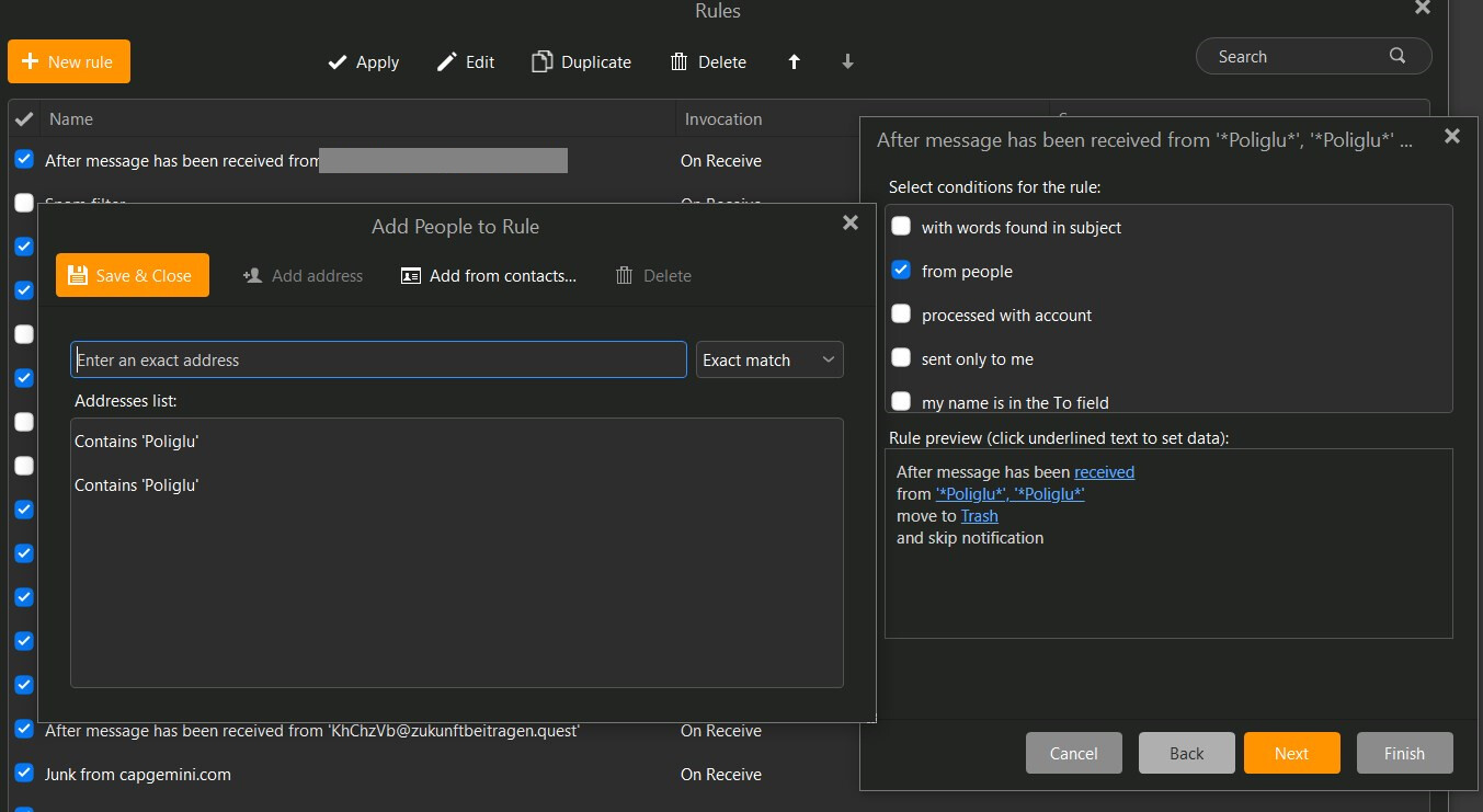

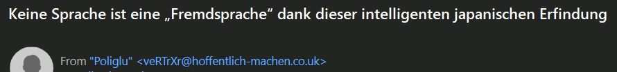

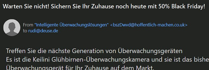

I very often get spam where some special words are in the from header, but not part of the from address.
The from field is
“Poliglu” [email protected]
Since the from address always changes (and probably doesn’t exist), I have to search for the word “Poliglu” in the from header field.
PLEASE NOTE that I don’t want to search ALL header lines for this, only the from header field.

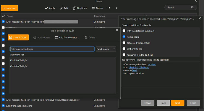

Create a rule e.g. “Filter for words contained in the from NAME” it is not possible in eMClient, or at least, I didn’t finde one yet.
Attached some screenshots what I tried, but that doesn’t work, because it only filters the from ADDRESS, but not the from NAME.
What can I do?

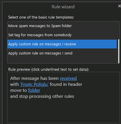

Try this rule…
@sunriseal:
Thank you very much for your advice, that worked in the case when the word starts right after "From: ".

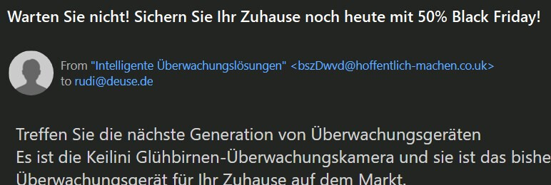

But what can I do if there is a different (always changing) text between the From and the word, like e.g.
From: “Intelligente Überwachungslösungen” [email protected]
From: “Beste Überwachungslösungen” [email protected]
From: “Gute Überwachungslösungen” [email protected]

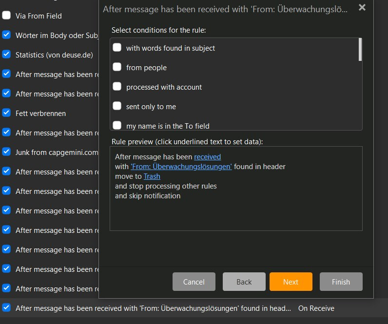

If I add such a rule with
From: *Überwachungslösungen
it doesn’t work.
That’s the reason I wanted to avoid just doing a search for only some text in the header.
I made some tests:
  • your suggestion with “From: Poliglu” worked, since there is some well-defined text but
  • “From: *Überwachungslösungen” didn’t work. And if I’d just search for “Überwachungslösungen” in the whole header lines, this would work for “Überwachungslösungen”, since the probability that this is a valid work in the header is very small, but not for other words (for which I have no example at hand).
I think it would be a good idea for emclient, that they make another rule template like “Search for text in from name or from address”, where wildcards could be used.
Or is there another way I didn’t see so far?

Quoted-printable strings don’t work, e.g.
Doesn’t work: From: =?UTF-8?Q?=C3=9Cberwachungsl=C3=B6sungen?=
Doesn’t work: From: =?UTF-8?Q?Intelligente =C3=9Cberwachungsl=C3=B6sungen?=
Doesn’t work: From: =?UTF-8?Q?Intelligente=20=C3=9Cberwachungsl=C3=B6sungen?=
Works: (“Intelligente Überwachungslösungen” as Base64)
From: =?UTF-8?B?SW50ZWxsaWdlbnRlIMOcYmVyd2FjaHVuZ3Nsw7ZzdW5nZW4=?=
Doesn’t work: (“Überwachungslösungen” as Base64)
From: =?UTF-8?B?w5xiZXJ3YWNodW5nc2zDtnN1bmdlbg==?=
