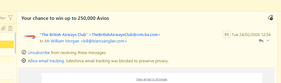

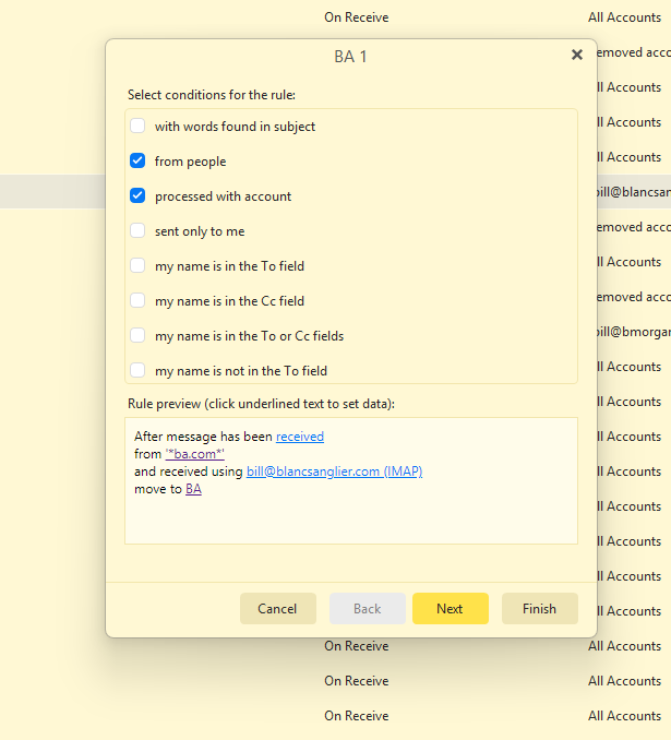

I have have set up Rules using the ‘and received using’ parameter - see example 1 in attached screenshot.
The software (not me) IS ADDING the (IMAP) suffix to the email address in the rule so the rule fails to move the email to the selected folder because it doesn’t match the from email address - see example email received 2.
Previous versions of eMClient didn’t add the suffix so older rules work as expected
I need a fix so that rules behave correctly.

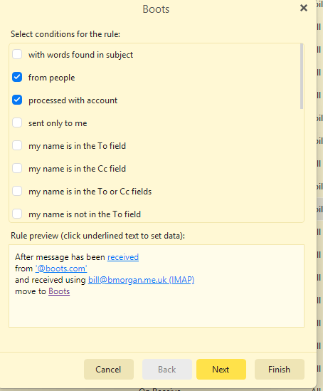

STILL NOT FIXED IN LATEST RELEASE 10.4.5298.
see picture of rule failing attached

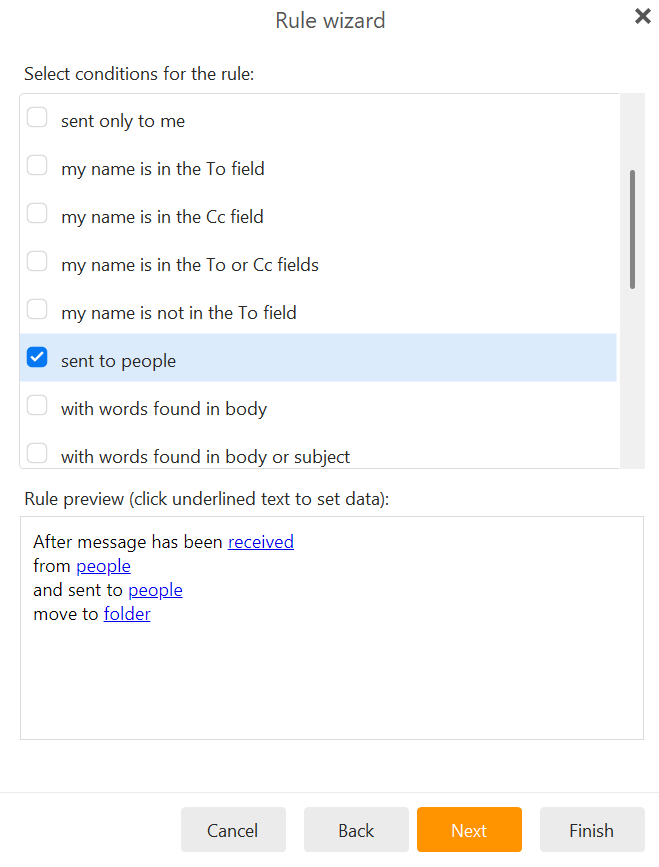

I’m sorry this has caused frustration. Try adjusting your rule to using the condition sent to (email address) rather than received using (an account).
Hi Kim and thanks, that works but the team at eMClient should still fix the underlying problem with received using which only started happening last year.
