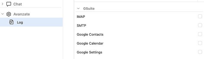

Hi Ron, uhmmm is a strange behaviour. May I suggest you to enable the IMAP and SMTP Log for a better diagnosis? Enter in the preferences and search “LOG” without brackets in the searchbar. LOG is under “Advanced” section.
The try to repeat the behaviour and try to read or paste here the log if you find anything intersting. This could be helpful!
