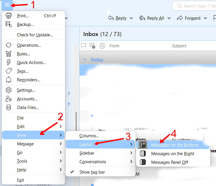

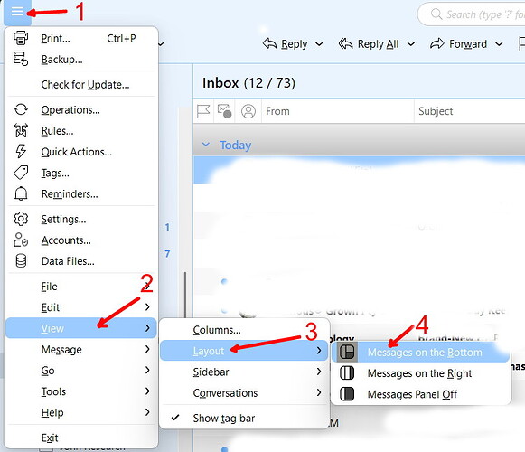

Hi John_A … As one who is obviously familiar with the eM Client display perhaps you can advise me on how I might move the reading pane from beside the email listing to underneath the list of emails. I looked through settings and couldn’t see how I can do this. It was pretty easy with MS Outlook.
Thanks. The version of eM Client on my desktop allows me to open up the menu selection as you have shown in you uploaded image and allowed me put the messages on the bottom. However, the problem lies with eM Client on my 9 inch tablet in that that version does not have the three bars at the top but only the “Settings” gear icon on the bottom left of the screen. This means that I am unable to bring up the “Data Files” menu. Why the two versions of eM Client downloaded on the same day on separate devices look different, beats me!
I only use Desktop version so unable to comment on your Tablet version.
