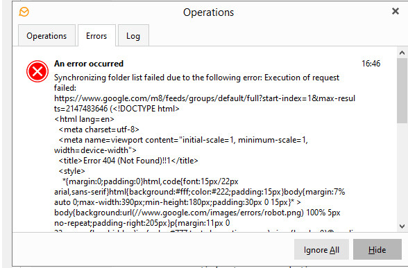

Em client stopped working today! ionos mail server
Yesterday all was fine with our work emails - today, none of the accounts will sync properly!
I can log in to my ionos webmail with the same credentials i’m using in em client so I know it’s not a password issue.
When I try and diagnose the connection in em client, I’m occasionally getting a green tick on the imap test, sometimes on the smtp test, but never both together. Literally one day working then one day not
Could this possibly be a licence issue? I’ve had no notification of expired license and i’ve got a x3 business licence I’m using here and em client isn’t working properly on any of them?
We’re on windows 10 machines. I’m tempted to just buy a new 3 license key and try that
Come on guys, nobody can help? What is this error that keeps showing every time I start em client?
