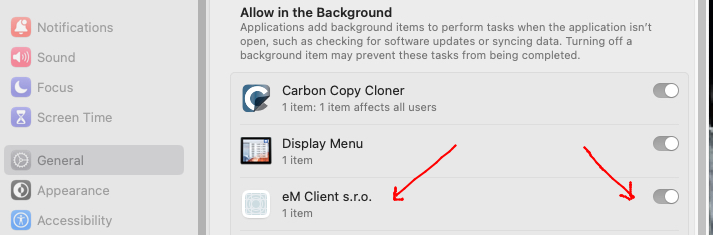

Can you check a setting please in your Mac System Settings > General > Login Items.
The eM Client entry needs to be enabled in the section for Allow in the Background.
Yes eM Client is already enabled in the Login Items / “Allow in Background” as per below screenshot.
Ive even tried today disabling that slider and re-enabling that slider but still the same problem.
