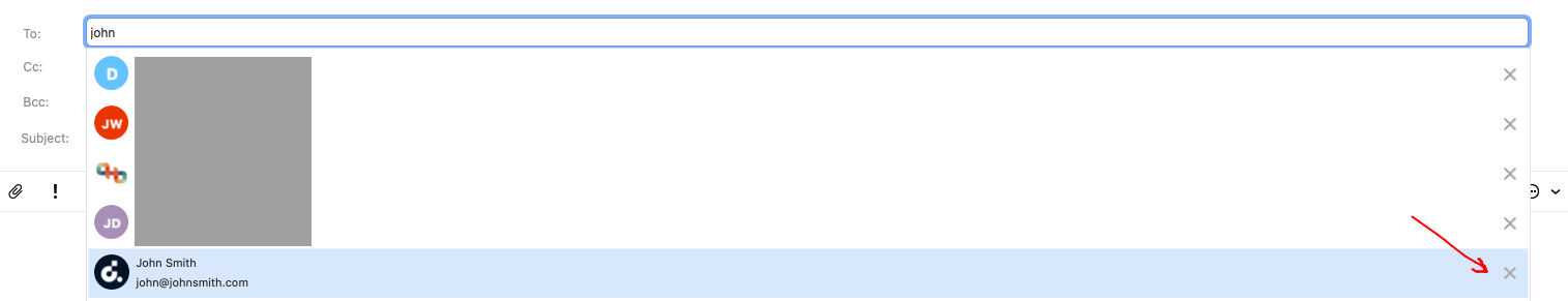

If the email address is still appearing when you type a couple of letters of the persons name in the To: line, and its not coming from the suggested sent folders or stored recipient’s as in @sunriseal screenshot example above, then it will be coming directly from your contacts.
Click on “To:” and then select “All Contacts” in the dropdown on the right as in the screenshot examples below. Then search for the contact in the “Filter Contacts field at the top left”, or scroll down manually till you find the offending contact in the list. Lastly “right click on the contact” and delete it.
Or alternatively go to eM Client Contacts directly and search and delete the contact that way.
Also some suggested contacts you can manually remove them by “Clicking the X” at the end of the suggested contacts in the dropdown To: line as in the screenshot example below.
