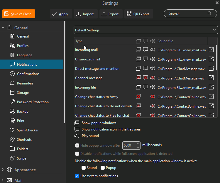

created custom sound for inbound email - it is not being selected. It is a .wav and is placed correctly with the other 3 emclient sounds.

i switched to a mini-music clip and it works - some reason it did not like the Voice recording
I switched to a mini-music clip and it works.

I can’t even get the default eM Client wav files to play. It is just not working.
Edit; it also does not show notifications, even though it is specified in settings.
