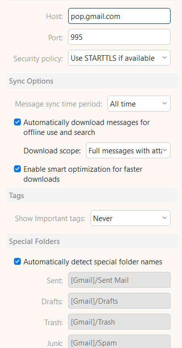

I didn’t want to restore ancient backups until I stabilized my eM C setup, so I tried to change from IMAP to POP, for more control.
I went to GMail online and made the needed changes. It warned that making the change would be slow, but it has been several days.
When changing my eM C settings several fields that gmail requires are missing, as follows:
POP
Requires SSL (must be YES)

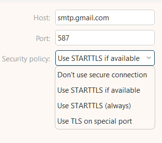

SMTP
Requires TLS: Yes (if available)
Requires Authentication: (must be Yes)
Port for TLS/STARTTLS: 587 ( I used STARTTLS, thinking it would get Port 587 from the Port field)

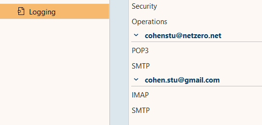

  • A red triangle shows every time I refresh (download) from gmail.

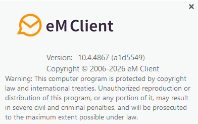

• eM Client Log Screen Shot.jpg As you can see, POP was not set up correctly.

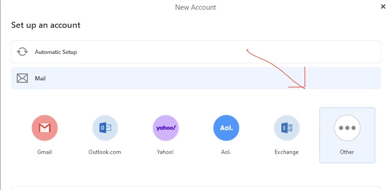

If you want to change from a Gmail IMAP account to Gmail POP account in eM Client, “you don’t change your current IMAP account settings”
You first need to “manually add your same Gmail address as a POP account” via “Add account / Mail / Other” and follow the manual wizard, which will authenticate via an OAuth token and ask you to give eM Client access to your Gmail account and then will automatically put in the correct Gmail POP and SMTP settings.
Note: At the end of the POP account wizard (before you click finish) make sure to choose if you want your POP account mail in a separate Account folder or in Local folders.
You should then see two accounts with your same Gmail address. 1 x IMAP & 1 x POP
The POP account settings should be.
Incoming Server pop.gmail.com
Port 995
Security Policy "Use TLS on Special Port”
Outgoing Server smtp.gmail.com
Outgoing Server Port 587
Security Policy "Use STARTTLS (Always)
Once you have your Gmail POP account setup, then “drag / move all your existing Gmail IMAP account mail and any custom mail labels (folders) into your POP account”.
Next once you are confident all your existing Gmail IMAP account emails are all in your POP account then remove your Gmail IMAP account.
Note: After you move your Gmail IMAP account mail and mail folders to your Gmail POP account, eM Client will then start synching. To see when that’s completed click the dropdown on the right of Refresh and click “Show Operations”. It can take time depending on the size of your online mailbox.
Lastly be aware that if you change to POP, “only your Inbox will synchronise” to eM Client and “no other folders will sync to any other device”.
