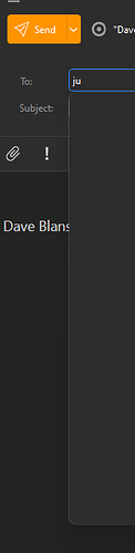

I am attempting to send an email to a recipient that is already in my sent folder. I start typing the name & get a drop-down After the first character with the list of 10 potential recipients. When I put a second character in, the list disappears. I have already gone into Settings to change my disered method of lookup.
I have also attempted using the “Clear Recipients History” button to reset the lookup.
Is the lookup limited to only 10? The person’s name begins with JU, falls outside of the list & will not show. Since the entire suggestion list clears when I type in “ju” I am unable to find the contact.
I have also attempted to use the email address in the TO field & have the necessary option marked to enable autocomplete by email address
Again, when composing the message, typing the first character returns a list of 10 potential recipients, not showing my contact in that list. Typing a second letter causes the list to clear.
even typing though to the @ sign does not complete any lookup to autofill the address.
