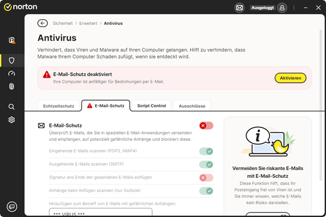

Hi,
i’m running into the same Problems. After i deactivated the Email Checking in NORTON the eM Client works again with NordVPN. But thats not the final solution i think. Any ideas someone?
regards,
Eberhard
As eM Client is now working ok with your VPN “by disabling email scanning in Nortons”, then i would suggest you contact Nortons technical support for assistance with that. Let them know as you said, that was the only way you could get your mail client to work with Nord VPN.
Note:- Alot of Antivirus programs in general “do tend to block mail clients” with the email scanning / checking enabled. So most users just end up disabling the scanning of the receiving mail as you have done, so the Antivirus program “is still resident in memory to intercept viruses”, but not interferring with the mail receiving.
