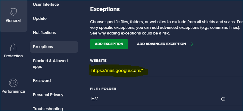

I have however found a solution - In Avast, add GMail as an ‘Exception’ to Mail Shield.
In Avast interface select Protection/Menu/Settings/Exceptions and add GMail URL to list of websites to be excluded from shield:
So far, this appears to be working.
An update to previous comment…
This appeared to work for a while, but the same connection error has now returned.
So back to square one!

Yes I mentioned previously, adding eM Client as an allowed program and exporting Avast certificate into eM Client is no guarantee that it will always work 100% everytime due to the way Avast works.
The easiest solution if you want to use Avast is “just to disable the Mail shield” so it’s still still resident in memory & then doesn’t interfere with eM Client.
Alternatively as mentioned contact Avast and they may be able to assist you to make it work. I personally would just uninstall it & not use it.
