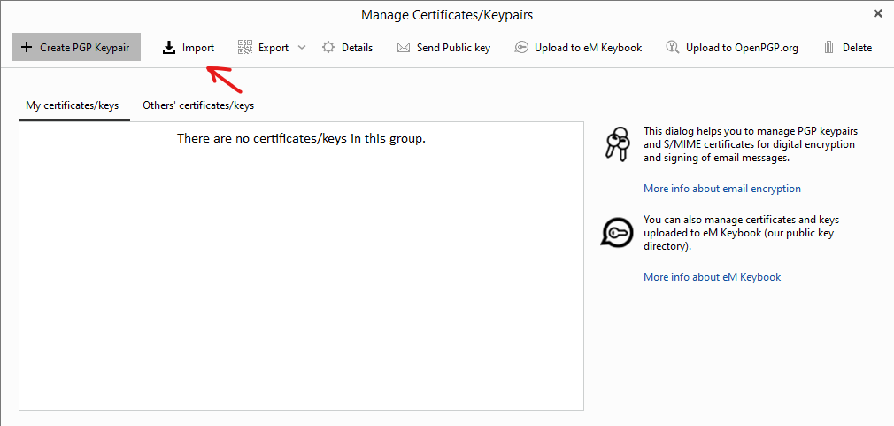

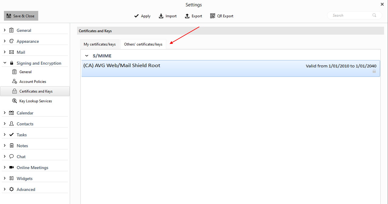

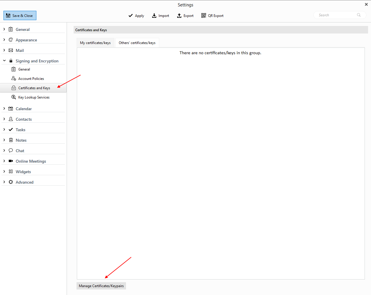

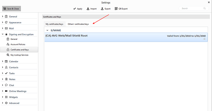

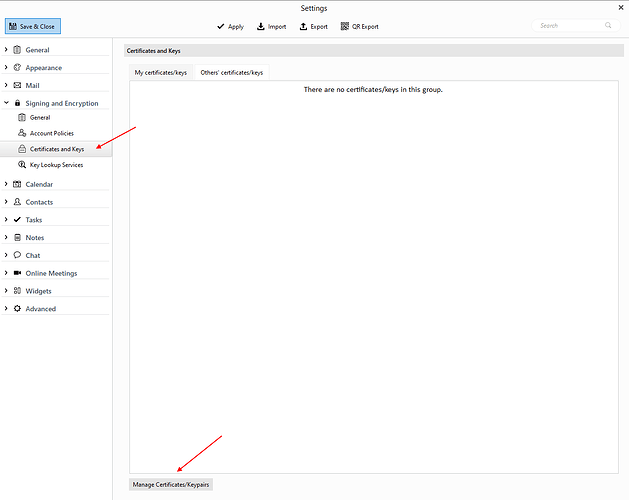

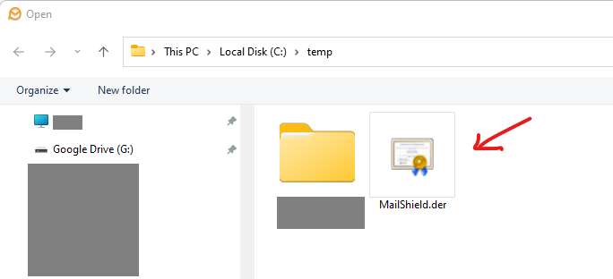

You can optionally though try exporting the AVAST mailshield certificate, and then importing that into eM Client via the “Menu / Settings (Preferences) / Signing and Encryption / Manage Certificates”. That sometimes has worked, but no guarantee. See below.
