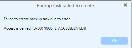

Noticed that my backups have stopped working after upgrade. Recommend checking your backups to make sure they didn’t stop as well.( I didn’t get any notifications just noticed it today when looking at the settings that my last backup was before I upgraded.)
If I try and set up any new backup I get:
This is not good. Anyone figure out the work around???

I had the same problem after upgrade; it was resolved by deleting the old backup folder (if it exists after upgrade).
Create a new folder named #BACKUP# or whatever name you want and where you want, then go to:
Menu -> Settings -> General -> Backup -> Target Directory and browse to directory/folder you have created.
This worked for me.

Thanks for the suggestion.
I tried deleting my old backup folder and then created one with a new name.
Did not work for me. Same error.
Hopefully this will be a high priority for the devs to fix. I would categorize this as a major bug.

Sorry that didn’t work for you, however, on reflection I seem to remember that I changed the location of the Backup folder.
As I modified the msi installation routine for eM because it wants to install to C:// as a default - I never install anything to C:// and keep that solely for the OS.
My eM installation is on E://
I don’t even have anything in C: Users -> Your user name -> AppData -> Local -> eM Client - my Avatar Cache is also on E://.
Consequently I don’t know what was the default location for the Backup folder; I created the new folder at:
E; Program Files/eM Client/#_Data/#Attach# #Backup# #Calendar# #Themes# eM Client (database folder)/ a whole bunch of files + sundry folders including Archive, Local Folders, Logs, Search Folders
I guess the bottom line is that you could try not only another new name for the Backup folder but also a location; the reasoning for this is that the access error code indicates an extinct or bad Registry entry.

Changing file location for backup made no difference. Original was on S: Drive, tried C: same error.
I don’t mind editing a single registry entry but no way I will run a registry cleaner as they are known to cause as many problems as they fix.
The developers need to create a patch for this as this is a V8 issue from upgrading 7->8.

Still no solution to this problem.
Is there a way to make a manual backup and restore if needed. Has anyone tried this as well to see if it works.
I assume the program needs to be turned off so the database is closed. But what are the instructions to backup and locations.

Hi TikiG…
Sorry to hear you still have an issue.
As you are prepared to edit the registry, hopefully backing up before you start, I don’t
understand why you won’t use a registry cleaner because of anecdotal reports.
To make a manual backup:
With eMC in view at top left ->Menu ->Backup ->Second item…
In next window you will be asked ->Do you really…
Click ‘Yes’ and wait until complete.
In the original window again top left between +New & Refresh there are two small
semi-circular arrows - these spin at start of backup and stop when complete.
