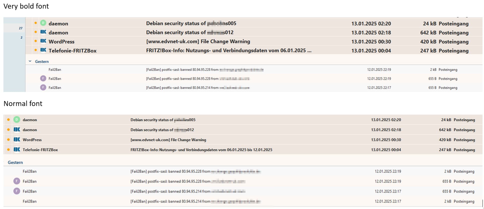

I have the same problem, which usually disappeared again after a PC restart. Currently, however, it remains like this and the bold font is very unpleasant. It changed after I
The trick from @Rolls360 works for me too. After this the list font size is shown smaller, so I can read more from the subject:
