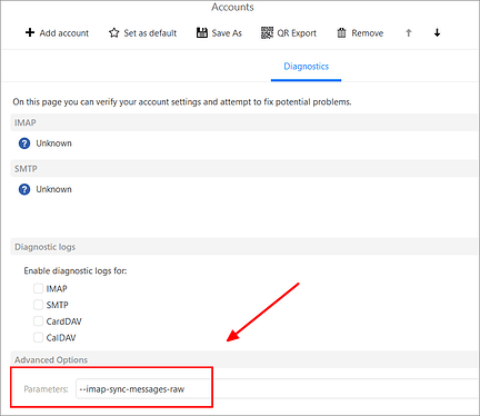

You can also try the raw sync. In version 9 go to Menu > Accounts and click on the Diagnostics tab for that account.
In the Advanced Options parameters box, paste in this text:
--imap-sync-messages-raw
Click on Save & Close.

Neither option is guaranteed, but it may help until we can release the workaround.
