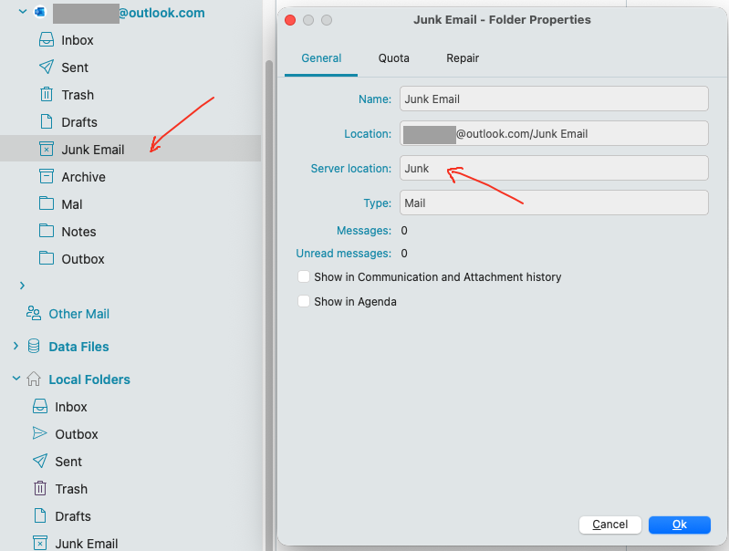

Folder Name is Reserved
That could mean that your Junkmail Folder name is possibly eg: “not spelt correctly” in your Outlook.com Account setup.
So first on the left under your Outlook.com account “right click on Junk Email” and click “Properties” at the bottom. Then under “Server Location” it should say Junk as in the first screenshot example below.

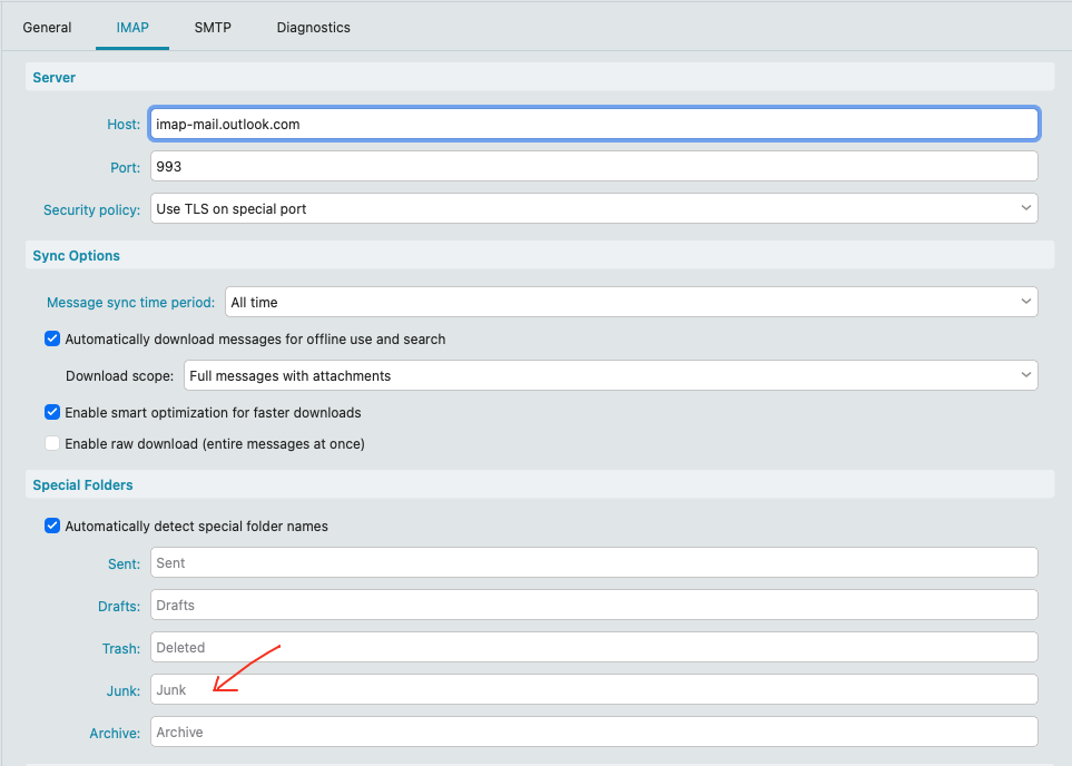

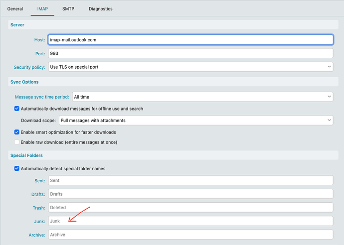

Then go to “Menu / Accounts” and click on your Outlook.com account on the left side and then click the “IMAP” tab and check under Special Folders that Junk is called Junk as per the second screenshot example below.. If its not called Junk, “remove the check automatically detect special folder names” and correct it & save accounts.
If its already called Junk, then “remove and re-add your Outlook.com account again” via the “automatic account wizard” which should normally detect the correct folder name.
