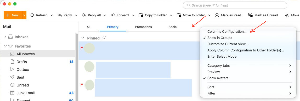

You can “right click on the toolbar above the messages” and click “Colums Configuration” and remove anything you don’t want. eg: The Icons on the left are the Avatars.

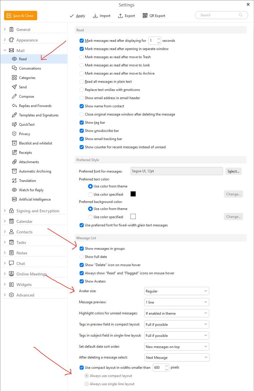

You can also go to “Menu / Settings / Mail / Read” and enable Message Groups to separate the Inbox message days etc. You can also adjust the Avatar Size and other compact layout options.
This is helpful. Actually the avatars help delineate the messages, but making them smaller makes them no so intrusive. I made the height as high as possible and this helps. But I would still like to ask for the enhancement of a horizontal line which would make it idea. But much improved. Thanks
