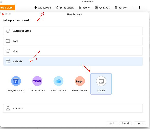

As you have already added your mail account previously without the Calendar, you can then just manually add a “CalDAV” [Web.de](http://Web.de) calendar via URL as per @Gary post below on the following thread.
Go to “Menu / Accounts / Add Account / Calendar / CalDAV” (Pc) or “eM Client / Accounts / Add Account / Calendar / CalDAV” (Mac) and following the prompts.
[https://forum.emclient.com/t/gmx-web-de-caldav-probleme/49604/2](https://forum.emclient.com/t/gmx-web-de-caldav-probleme/49604/2)
@Gary post extract below from the above thread.
[web.de](http://web.de/)
CalDAV: [https://kalender.web.de/begenda/dav/users/](https://kalender.web.de/begenda/dav/users/)
 ![image](https://forum.emclient.com/uploads/default/original/2X/2/2d7d00b4aec5af14e9028e8475358f9ba0db6988.jpeg)
